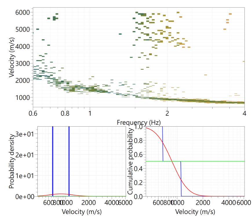

4. In some cases, there is gap (frequencies with very few blocks) could be seen on the dispersion curve. For example, around 1.24 Hz in the attached figure. May I ask for your opinion?
Did you try to browse the FK spectra at that frequency? Peaks outside MIN_V and MAX_V? The probabily density plots shown in your figure, are they computed at 1.24Hz? I have the impression that it is at a higher frequency because the first peak is below 1000 m/s. Does 1.24 Hz is where there is only a single bin around 1200 m/s? Maybe all values at that frequency are very close. Definitively, having a look at the FK spectra at 1.24 Hz might be instructive.

For the attached dispersion curve figure, the probability density is not computed at 1.24 Hz as you said. Sorry for the confusion.
I have checked the FK spectra, and the reason of the gap around 1.24 Hz is just as you said, the maximum peaks of FK spectra have the velocities above MAX_V, so they might be filtered and not be included into the output max file.

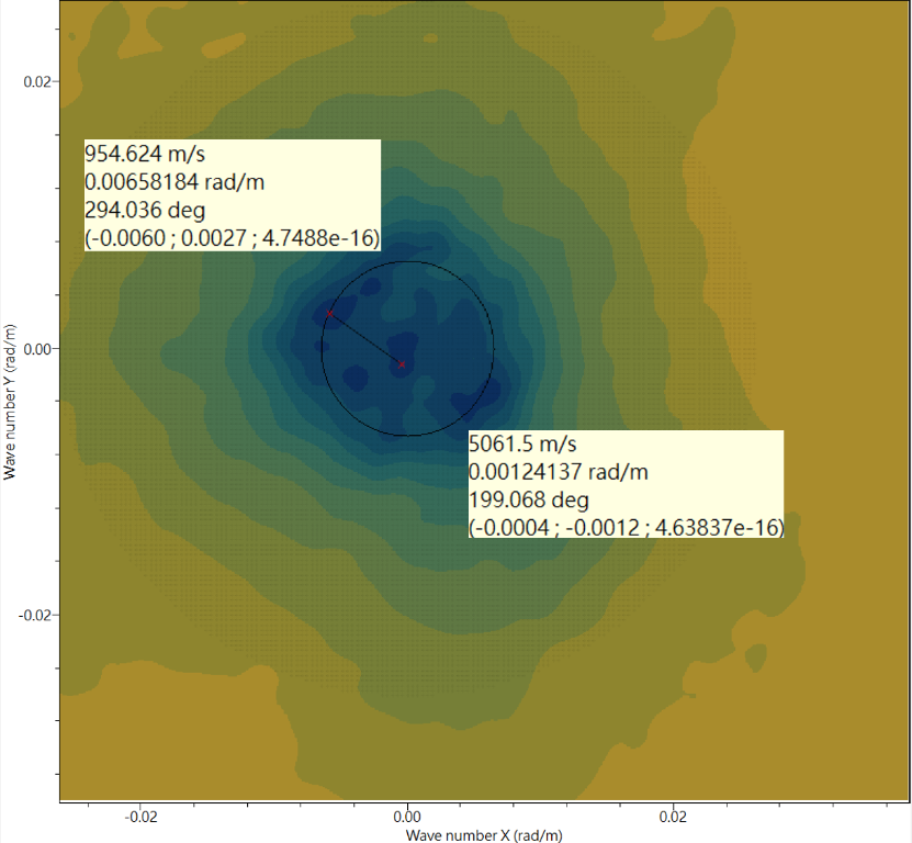

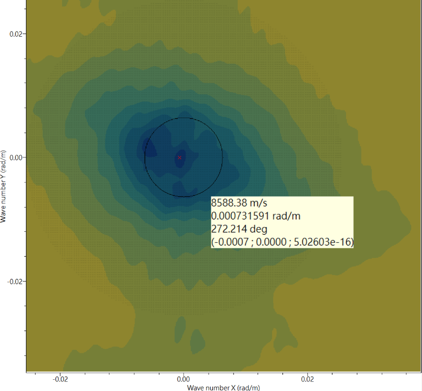

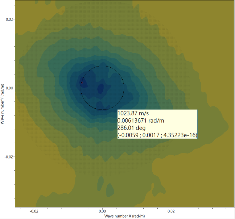

Here I attach two figures, they are the FK spectra of a dataset utilizing single component HRFK. The parameters for calculation are the same except one allows 1 peak on FK spectrum (FK_max1peak_relative0%.png), and another one allows two peaks (FK_max2peak2_relative0%.png). No threshold (absolute or relative) is utilized. The yellow block shows the information relates to the peak.
As you can see the peak positions (red X) between 2 figures are different.
In FK_max2peaks_relative0%.png, for some reason, the peak with 2nd strongest power been chosen, and no peak been picked at the position with the strongest power. Moreover, although the maximum number of peaks is set to 2, only 1 block appears two peaks within the 28 blocks (fig3.png). I took a quick look and I believe this happens when the power of outside peak (larger wavenumber) is larger than the inside peak.

I think that the strange movement from one peak to the other is linked to a bug in the display that I fixed at the beginning of July (unsure, vacations since then). If you are running under Linux, I would be curious to see the difference if you install the latest development through git repository (branch 3.6). It includes also the choice of an experimental derivative based algorithm to search the peaks (option in FK parameters).

After few more testing, I believe the reason that there was only one peak on the FK spectrum in FK_max2peaks_relative0%.png is because the vmax in FK gridding.
Here is what I am thinking, please correct me if I am wrong: When N peaks are allowed, geopsy first picks N maxima on the FK spectra and then filter the result within the v range (vmin to vmax). So the peaks without the v range will be excluded and not plotted on the FK spectrum, which makes the peak on the figure looks like shifting. However, when only 1 maximum is allowed, the peak with maximum power will be picked and plotted on the FK spectrum, no matter whether it's within or without the v range. In this case, if the calculated velocity is without assigned v range, it won't be written into the max file.

min and max velocities are used to define the grid search (translated into max and min wavenumbers). N maxima are effectively picked using the grid search. Upon saving the results, the min and max velocity are again checked. I'm unsure whether this second check is really useful. Close to the wavenumber limits the second condition might be useful. In your case, all peaks are well inside the wavenumber limits and such case should not happen. 3.5.2 does not contain the required corrections for showing all peaks. You have to compile the binaries from a source tree downloaded with git, to be on the latest branch where I did all recent modifications. I recently wrote a tutorial to compile under Windows but it is easier under Linux.
