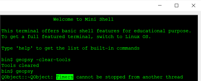

Re: HVSR crash when i click the start botton
I already download 3.4.2 again and remove all others.
On the other hand, I tried the code you shared, but it still crash when HVSR come to click the start button.
Below is the picture with my GeopsyLand. Actually, HVSR still worked 5 days ago and I didn't download anythings with my computure.
The crash problem just appear without reason.
thanks
thanks
Is there a report after the crash?
If so, can you copy the text here?
The bug collection facility is now repaired but it works only with the latest release to be published in a few days (3.5.0).
