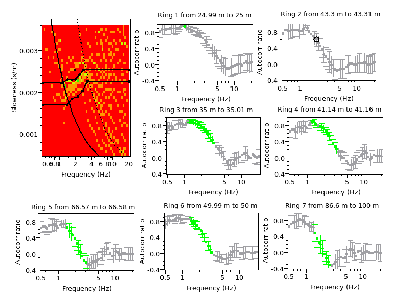

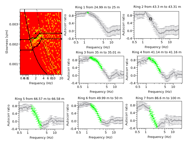

In fact, looking at spac2disp snapshots, your original spac curves are quite nice. From the shape of the dispersion curve that can be outlined, which looks almost flat, I suspect that the interesting and dispersive part is at lower frequencies, below 1.5 Hz. Do you have an idea of the H/V peak frequency for the area?
Kmin and Kmax determined using build_array are suitable for FK processing. For HRFK, it can often be extended a bit. For SPAC there is no quantitative measurement of the limits. The resolution limit may be 2 or 3 times below the kmin observed for FK. Currently, from the visual inspection of the dispersion plot in spac2disp you can define the limits for spac. Don't be too restrictive. I think that in your case you can extend the range of validity up to 4 or 5 Hz (especially for smallest array). At low frequency, I think that you selected the correct limit.
One question that's not clear in my mind: are you recording all three arrays at the same time? If not, why did you set up only three stations for the small array?
Finally, your post suggests that there's a mismatch in saving target curves in dinver. Right? Which version are you using? I also wander if it would be possible to include all target files from the three arrays into spac2disp... it might be better than analyzing them separately. I'm looking how to do it. Can you send me the three target files? So that I try here.
We cannot go to the inversion part before setting the spac curves correctly. Let's first solve the first part...

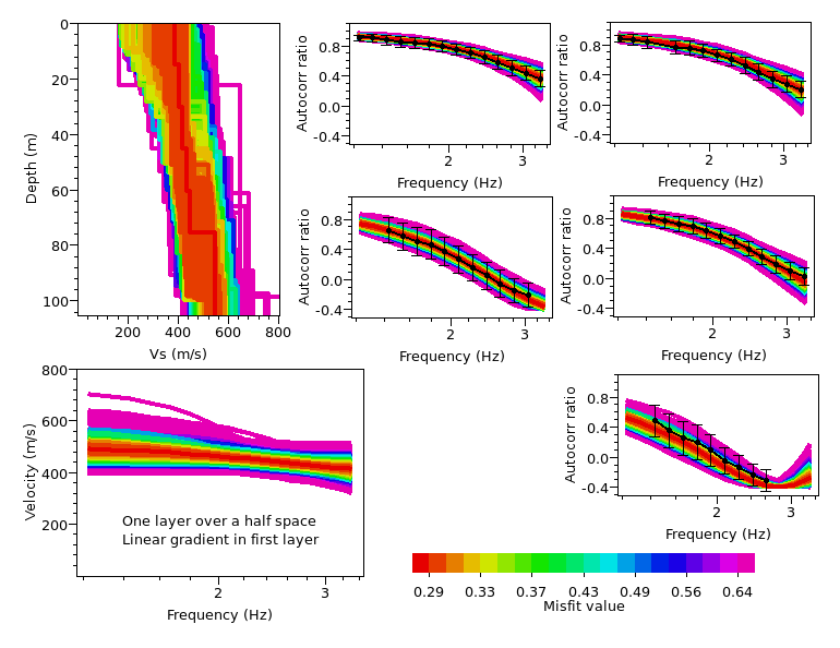

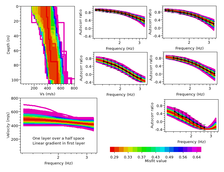

I analyzed the three arrays at the same time (possible only with the next release):
I discovered that your spac curves are not sampled the same way. To process them in spac2disp, you must have the same sampling (option of the processing). In this case, I cut and resampled the curve between 0.5 and 20 Hz, with 50 samples in log (using Dinver, now export of target is working properly, next release).
A single target file is saved from Dinver and in spac2disp, all rings match a single dispersion curve between 1.5 and 3.5 Hz, except the first two rings measured on the smallest array. I suspect that the reduced number of station pairs (3) for this array leads to slightly biased results. I discarded those two rings after loading the selected target in Dinver.
When you load the target file into dinver, the empty rings are still there. Don't forget to remove those two rings. I used a very simple model for the inversion and got finally very good misfits.
All rings are well fitted except the last one. The frequency band is not different from other rings so the misfit cannot be improved by adding more degrees of freedom. This probably due to particular ground configurations or noise structure viewed by the larger ring.
It would probably help understanding this structure if you have H/V ratio. The depth of investigation is difficult to estimate because the dispersion is almost flat. From the wavelength criteria, I would say that we have information down to 100-150 m (1/3 of lambda). The maximum depth was fixed to 100 m so all information below is not valid.
What can be learned from this inversion probably that you need lower frequency information (to be confirmed by H/V results).
- Spac results, first two ring are not selected
- (49.07 KiB) Downloaded 561 times
- Inversion of spac results with a very simple model (too simple?)
- (56.11 KiB) Downloaded 578 times

I checked your target with spac2disp and in fact the selection is probably too large. The first two rings have a dispersion curve far from the one from all other rings (local structures close to surface not viewed by larger wavelengths?). Your high misfit comes from the fact that it is no possible to find a single dispersion curve explaining all autocorrelation curves. When you run the inversion with all 7 rings the solution found falls inside the distribution of models shown in the figure above. Still, a small contrast is visible (from 350 to 500 m/s).
The only way to decrease the misfit is to discard some points or entire rings from the inversion. But at the end it won't change drastically the Vs profiles. I think that the best to do now is to process H/V in the area and decide whether you need larger arrays or not.
