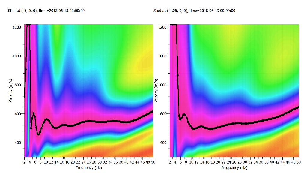

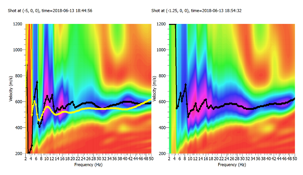

I have Geopsy in two computers and I have a problem.
the first computer is a desktop with AMD A10-7800 Radeon R7, 12 compute Cores 4C+8G 3.5 GHz (I don't know what does it means)
the second one is a laptop with Intel i7
I use the same 'elaboration settings' for the two computers
At first glance I thought that problems were only problems of visualization but there are also difference of calculations.
I send to you the .png of the two different elaborations
I see that the AMD's elaboration figure is less accurate, less continuos than the Intel one and is more difficult to pick a dispersion curve
Isn't it?
But also the autopick curves are different. the yellow one is from Intel and is 'slower' than the black from AMD.
Can someone help me? I have to use only Intel?

Are you 100% sure that you did the same computations?
The naming of the shots are different in your Intel and AMD plots. Are they really processed on the same data set?
On the AMD plot, I can see typical features encountered when time windows are too short (sparse frequency sampling in the FFT). A common way to avoid it is to add zeros at the end. In geopsy, define a processing window that is larger the actual data length.
